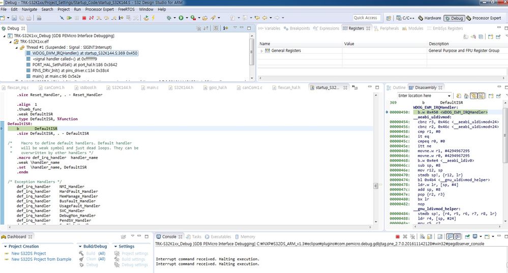

■ Situation : during debuging, source code is stopped at 'DefaultISR'

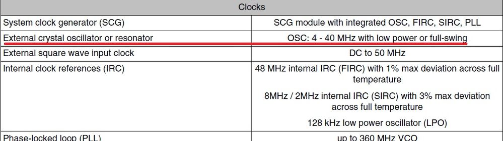

■ Difference between NXP PCB to my new PCB : XTAL
- NXP PCB : 8MHz
- my company's new PCB : 40MHz
※ refer to Device feature summary of datasheet(51page)

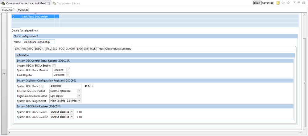

1. System OSC Clock : change from 8MHz to 40MHz
 1) NXP PCB : after changing from 8MHz to 4MHz, I confirmed the source code was stopped at 'DefaultISR' during debugging.
 2) my company's new PCB : happened same situation. The source code was stopped at 'DefaultISR'
2. External Reference Select : change from 'External crystal oscillator' to 'External clock source'
 1) my company's new PCB : The source code was stopped at 'DefaultISR'
3.  System OSC Range Select : change from Medium to High

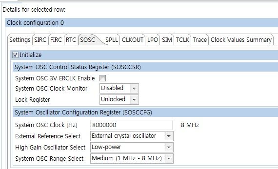

■ Component Inspector : before chagne(activation is ok)

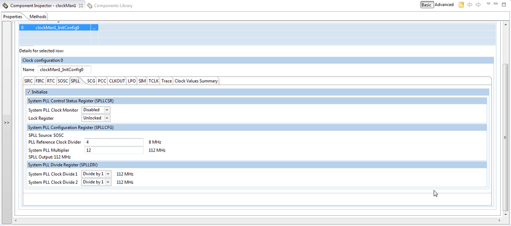

Probably related dividers/multipliers are set incorrectly. Check the warning messages. My configuration for 40MHz crystal oscillator is on pictures bellow.
Jiri
