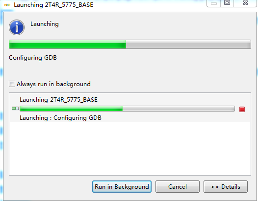

I'm working on flashing with MPC5775 using P&E multilink and S32.
When the program is debugged, the program cannot be downloaded.
like this:

then download program stops here.
Please give some feedback to resolve this issue.

I flashed test project and there is no issue on my side. Can you please share your project or elf (or srec) files?
