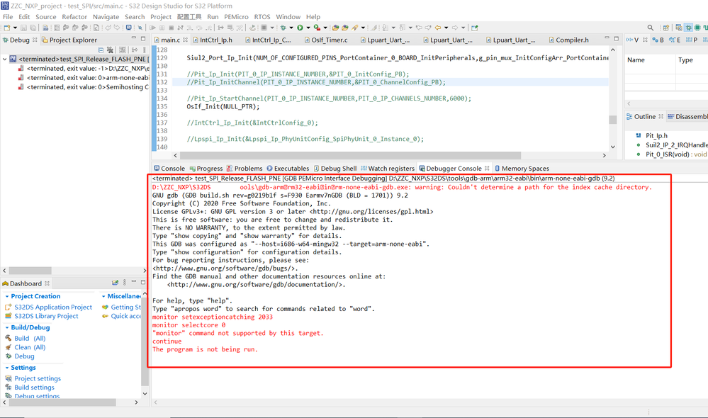

I use the S32K311 chip, and the burner uses the PE burner. But this error occurs when I select Debug after compiling the program.
monitor setexceptioncatching 2033
monitor selectcore 0
"monitor" command not supported by this target.
continue
The program is not being run.

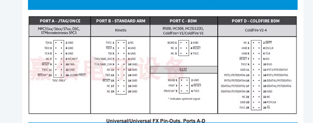

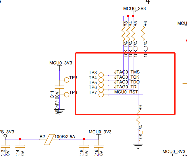

This is how my burner is wired. I chose yes
TP3--Port-B-7
TP4--Port-B-9
TP5--Port-B-13
TP6--Port-B-5
TP7--Port-B-15
I also connected VCC and GND on both sides
I would like to ask how this kind of problem should be solved
