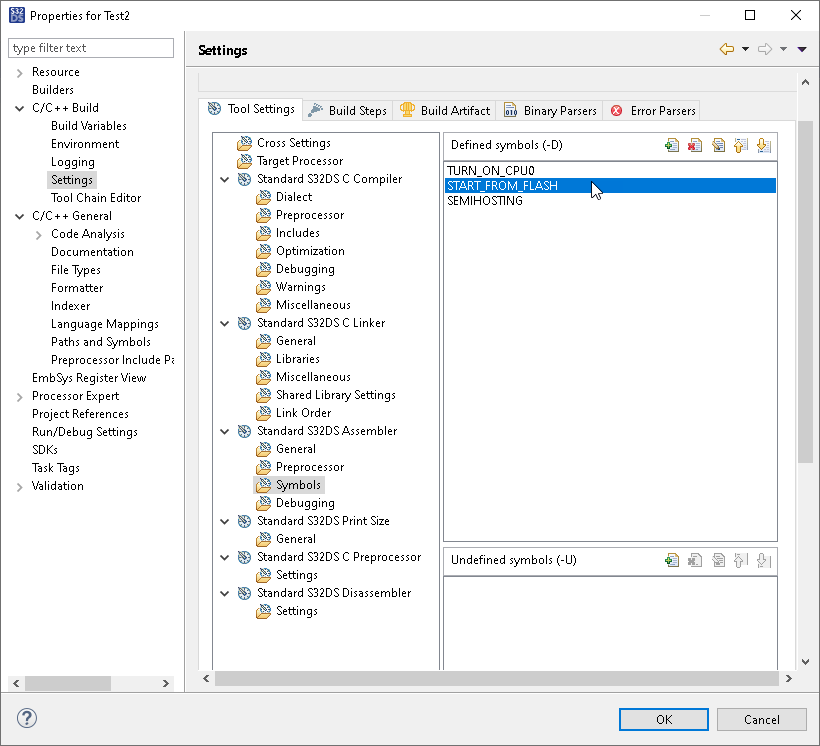

Dear NXP,
We are using S32K118 EV board, following the step, I create a simple DS project just to light up LED, we use the debug_flash option, and it is working after loading is completed, but when I power down and power up the board again, the LED won't light up again. i.e. seems programmes didn't flash inside the flash. I have attached my project code, can you advice what could be wrong with my project setting?
(If I try to use the example project from NXP, there is no such issue).
Thanks and best regards
He Wei

lukaszadrapa
If I create new project without SDK, the definition is present, so it works.
If I create new project with SDK, the definition is missing. So, the problem is on our side. I will report it. Thanks for bringing this into our attention.
Lukas

lukaszadrapa
I can see it's caused by missing ECC initialization of RAM memory:
#ifdef START_FROM_FLASH
    /* Init ECC RAM */
    ldr r1, =__RAM_START
    ldr r2, =__RAM_END
    subs    r2, r1
    subs    r2, #1
    ble .LC5
    movs    r0, 0
    movs    r3, #4
.LC4:
    str r0, [r1]
    add    r1, r1, r3
    subs r2, 4
    bge .LC4
.LC5:
#endif
This code in startup file is not executed because START_FROM_FLASH is not defined in the project. You can add the definition here:
And then it will work.
