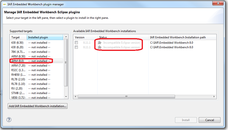

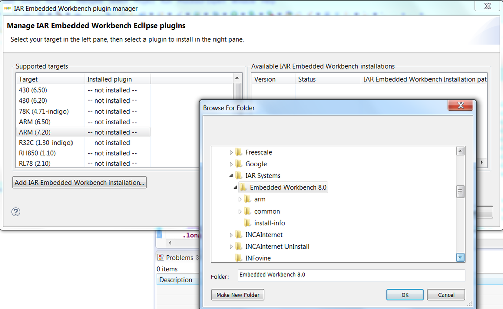

I tried to install IAR EWB but it couldn't be added, is it problem with version 8.0?

Hi Kate,
I've just made a test and it seems IAR Embedded Workbench for ARM 8.x could be integrated with Eclipse Neon version only.
So I'm afraid currently there is no way to integrate it with S32DS for ARM.
Stan
