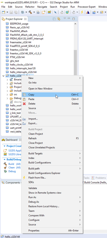

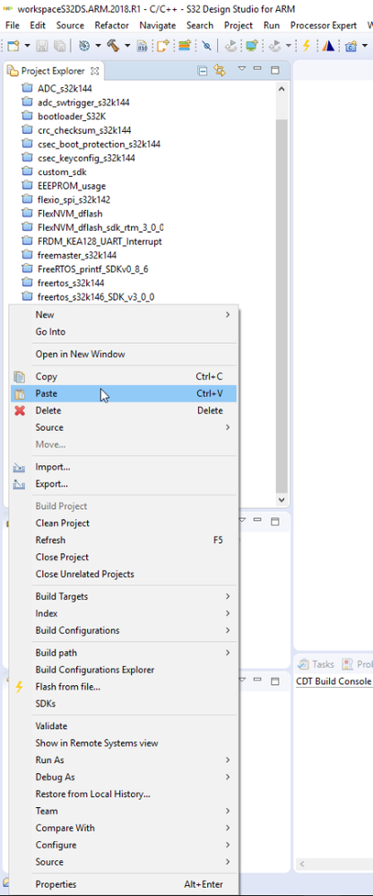

Hi Raju,
easiest way how to copy project is Right click on project name -> Copy
and paste it:
When you paste the project - you can modify project name:
Hope it helps.

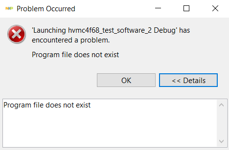

Hi Jiri,
I copied the project as you suggested and make necessary changes in the debug configurations like selecting the NXP device but, when I try to debug using the PE Micro
Also, I observed there is an project binary (.elf) file missing in the debugger configutations startup options
Kindly help in thhis regard,
Raju

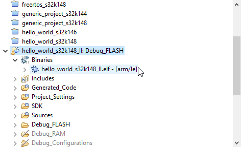

6,690 Views

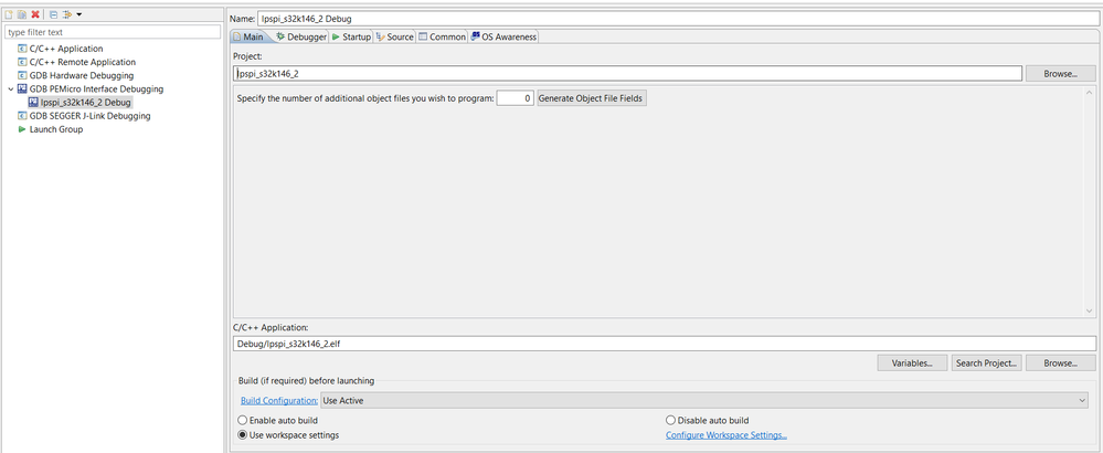

jiri_kral
Hi Raju,
did you properly build your project - is the .elf file present in Binaries?

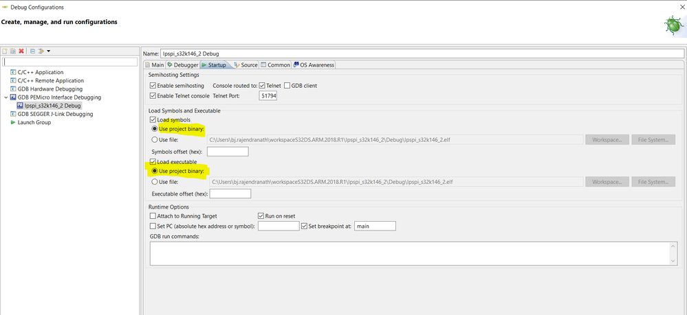

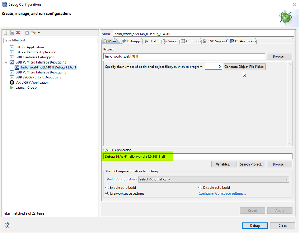

Also make sure, that Debug configuration is pointing to that .elf file:
If the .elf file is present - you should see in Startup something like this:
Jiri

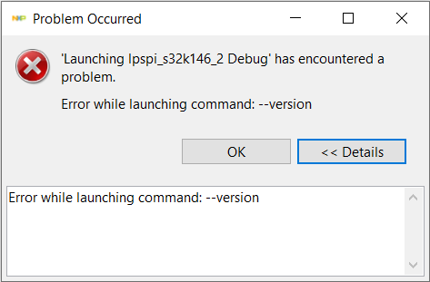

bjrajendra
Senior Contributor I
Hi Jiri,
As suggested, I just added the elf file using search project option and hence the elf appears in the startup as well. Then I tried to debug.
Now, I'm getting an new error as shown below. What to do now?
Raju.
6,690 Views
jiri_kral
Hi Raju,
you probably didn't enter GDB client executable in newly created DBG configuration:
Jiri

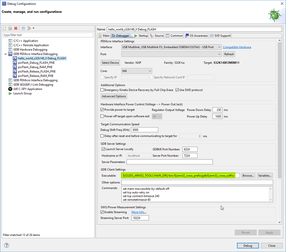

bjrajendra
Hi Jiri,
Then I added ${cross_prefix}gdb${cross_suffix}  as mentioned in the thread. I started working.
Thanks for your support.
Raju
