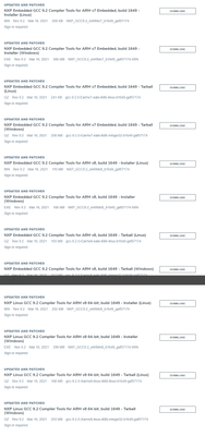

Hello @mikedoidge ,
in your reply you mention that it is possible to get the sources for the NXP GCC 9.2 compiler. I could however not find them in your download area. Can you give me a hint where I can e.g. find the sources for Build 1649?
13,017 Views
mikedoidge
Hello @mk_becker ,
Please look to the page: https://www.nxp.com/design/software/development-software/s32-design-studio-ide/s32-design-studio-for...
Scroll down to the Downloads section and select 'Show All'.
Now scroll down until you see the GCC 9.2 Compiler Tools downloads. There are Installers and Tarballs for both Linux and Windows for both ARM v7 and ARM v8.

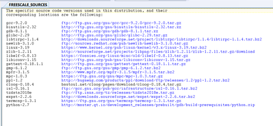

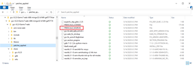

Hi @mk_becker,
Within the package you can locate the 'patches_applied' folder. This folder contains all of the patches as well as a file 'FREESCALE_SOURCES'. This file contains a listing of each source code package and the link to where it was downloaded from. The following images are from the GCC 9.2 armv7:
Mike
