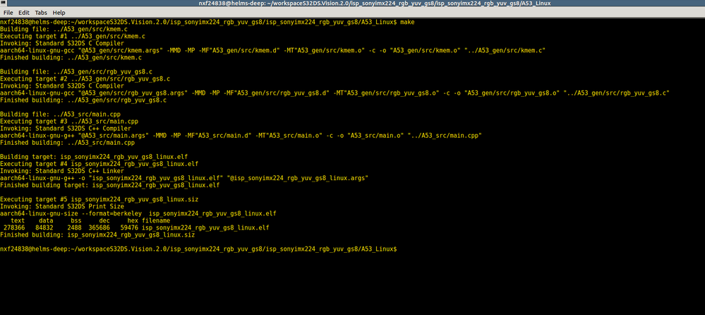

are you able run make from command line? You can try it in your project/target. Here is output from my command line test:
Jiri

hi,Thank you for you replay and the command  line  executable in windows system . And the question: Cannot run program "make": Unknown reason was solved after I modify some  configures of  my linux system . And now it was showed no error during my run the demos of S32DS . But there was another question . For some demos like apex2_face_detection , apex2_orb_cv , apex2_roi_cv ... almost all apex demos which I  run in S32DS for linux  was just could build simulation successful but with no result . That means after the I run  S32 application  project for EMU , it  could finished but not like in windows it will shows the result simulation (like some pictures which be processed in S32DS )  it was no result .
 That make me feel very confused and hope for the replay ,thank you !
