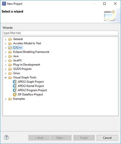

I have problems encountering the "ISP Dataflow Project" wizard. I'm using the 3.2 Version of S32 Design Studio. In the 3.1 Version it was still possible to select "ISP Dataflow Project":old.png

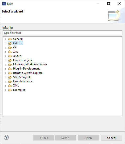

When I try to make new Project in Version 3.2 I only get this window:
 Where can I find the option to create an ISP Dataflow Project?

Hello nxf54269‌
The Visual Graph Tools comes as part of Vision Extension Package for S32V2xx v.1.0.0, however, this package is NOT SUPPORTED for S32 Design Studio v3.2. Please continue to use S32 Design Studio v3.1 until we release an updated version of the Vision Extension Package.
