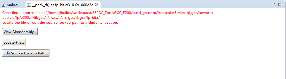

Can't find a source file at "/home/jbuilds/workspace/S32DS_ToolsGCC_E200/build_gnu/opt/freescale/ELvle/obj_gcc/powerpc-eabivle/fp/e200z4/libgcc/../../../../../src_gcc/libgcc/fp-bit.c"  Locate the file or edit the source lookup path to include its location
hi,everyone
  I create a new project about MPC5744P.this project I add 'math.h' file,but after run several times,project occurred a problem,I think the problem about I not correctly use S32DS .Problem like that:181863_181863.pngQQ图片20170418140510.png

I searched S32 Design Studio installation folder and this file is not contained. This means we do not provide this source code.
Which line in which file causes this problem? When you load the project into the microcontroller, does this project work (with/without debugger)?
Could you please provide me more details?

Hi Martin,
Thanks for you reply,after run the program several times,finally I found the problem arised when run "while(x<=65535)"in the main function.But the problem seems to  have no effect on my project,and the project works  with debugger.
