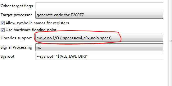

fyw
Hi  Sliva:
     I use the method from "Alexander Fedotov " (mv powerpc-eabivle\newlib\lib  powerpc-eabivle\lib)and still didn't work.  I search the folder "Cross_Tools" and find no file named "ewl_c9x_noio.specs". Is there any way that i can enable the link-time optimizer (-flto) option
Thank you very much!

alexanderfedoto
You are using EWL2 specs and EWL2 libs respectively. so in this case you need to move/copy lib folder from EWL2.
See my answer below for ARM.
For Power the trick almost the same:
mv S32DS\e200_ewl2\lib Cross_Tools\powerpv-eabivle-4_9\powerpc-eabivle\lib
