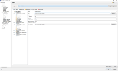

I am trying to add library file.
According to 'HOWTO_Add_a_static_library_file_into_S32DS_GCC_project' doc
I should add lib in 'S32DS C  Linker' like below
However, I cannot find tat setting category like below
I am using 2.1 ver for Power Architecture.
How can I find that

stanish
Hi Port,
the missing Linker project settings indicate this is a library project instead of an exectutable S32DS project.
The screenshot depicted in HOWTO document refers to the Executable project which adds a library.
Hope it helps.
Stan

jiri_kral
basically - there are two type of S32DS projects: Library (after build you get .a library archive file) and executable project (you get .elf executable file).
in library project there is no linker settings. Library is just set of functions.
Linker settings is necessary for executable (.elf) project.
Hope it helps.
