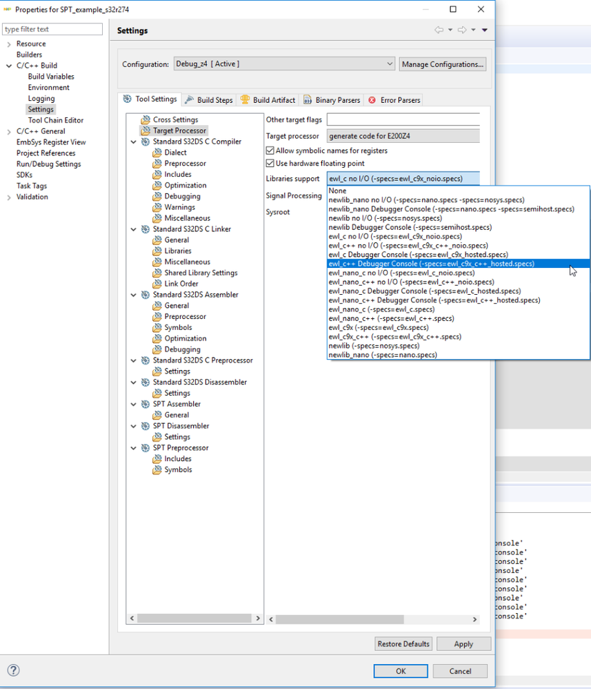

Sorry for delay. You need to switch C library to one supporting semihosting console (Debugger console):

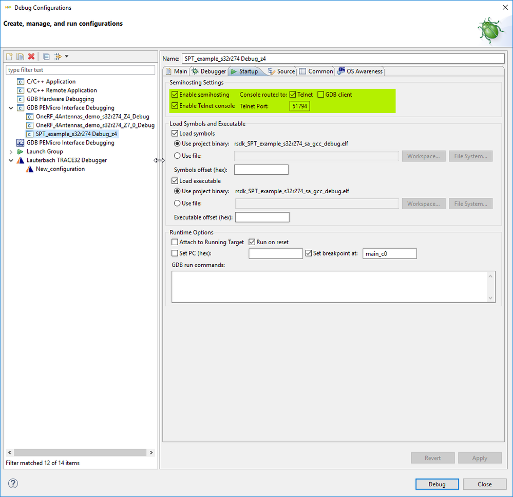

and be sure that Semihosting is enabled in debug session:

What I meant by saying "unable build example" when using PE Micro is in the SPT example code we have "debug_tool.c" file where we have an elif statement for PE_SEMIHOSTING_EN. So if you enable that then we got this error -
(make: *** [makefile:51: ./bin/rsdk_SPT_example_s32r274_sa_gcc_debug.elf] Error 1 SPT_example_s32r274 C/C++ Problem)
on console window and elf won't generate.

Thank you so much for the help, I am able to build the example.
