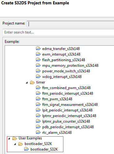

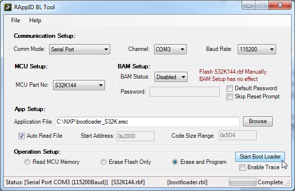

Example project is empty project configured for RAppID BL Tool. Inside project is testing .srec file (located in project's Debug folder) . If you have S32K144 EVB - please download updated Bootloader file (rbf). Copy this .rbf file into mass storage device on your S32K144 (on my machine it is drive D:\ ). Restart your EVB.
Modify bootloader.rbl file to point on testing .srec (I copied the file into C:\NXP folder on my machine)
Start RAppID BL Tool and open modified bootloader.rbl file and  press Start Boot Loader button.
If you wanna use RAppID BL Tool - starting with Bootloader_S32K example is good idea.

the rbf file is standard .srec file and it is bootloader for S32K144. Easiest way how to flash this file into S32K144 is copy it into mass storage device on EVB - the srec will be automatically flashed after reset. You can flash it by S32DS too.
You can see (from .srec file)  that bootloader occupied memory from 0x0000 up to 0x2000. You can also see that uploaded application starts on 0x2000 address (normally application starts after flash config on 0x0410 address).
There is no source code available for RAppID bootloader. In your case (updating firmware by other MCU) - you need to write your own bootloader for S32K144 and other side for your master MCU.
