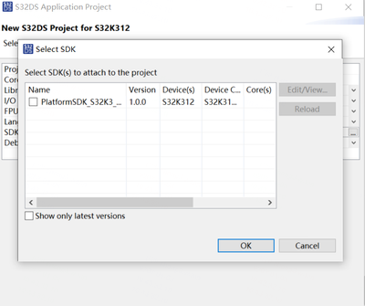

Hello all, I'm new here and it's my first time to use this product so I've got some questions.
At first, I downloaded this SDK for S32K312
SW32K3_RTD_4.4_R21-11_3.0.0_CD04_D2212_updatesite.zip
But after I installed it, I could not select any SDK when I was trying to build a new project. It didn't report any error during the installation. So I asked my colleague to try it and he got the same problem.
Then I just tried to download and install an older version which is SW32K3_RTD_4.4_1.0.0_DS_updatesite_D2110.zip
It seems that this can work but I wonder why the newer version didn't work.
How do I choose the the lastest SDK for S32K312?

S32DS v3.5 doesn't fully supports full S32K3xx device family. S32K312 is fully supported in S32DS v3.4:

From the provided information I infer that you are using S32DS v3.4, am I correct? If I a, the SW32K3_RTD_4.4_R21-11_3.0.0_CD04_D2212_updatesite.zip is provided as an update site for S32DS v3.5, so it is not possible to access it via an older version of the IDE.
Another possibility is that the software was not correctly installed to check that this is not the case you must see the package in the Installation Details.

I'm using S32DS v3.5 so probably it's not because of the version of the IDE.
I checked the Installation Details, and I found both RTD v1.0.0 and v3.0.0 from the Installed Software.
Does it mean I've already installed the software successfully? If so, it just puzzles me that I cannot choose SDK v3.0.0 when I'm trying to create a new project.
