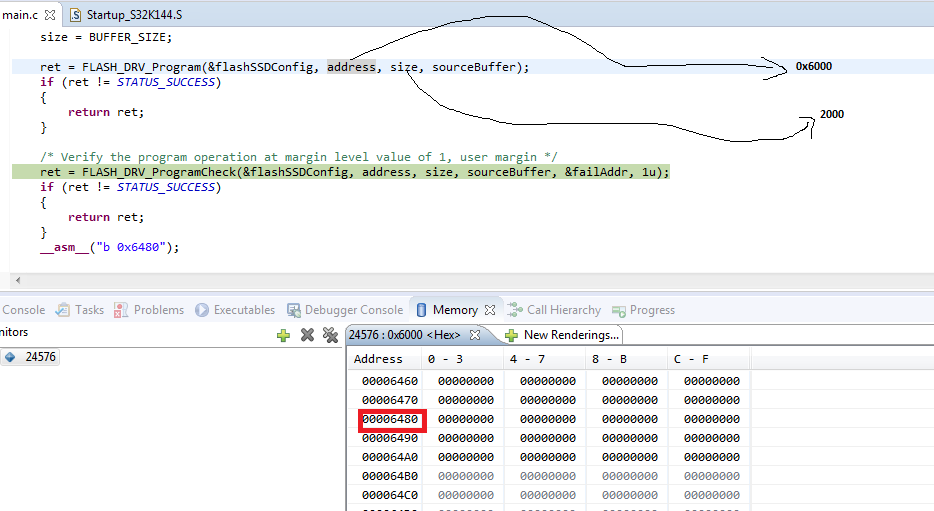

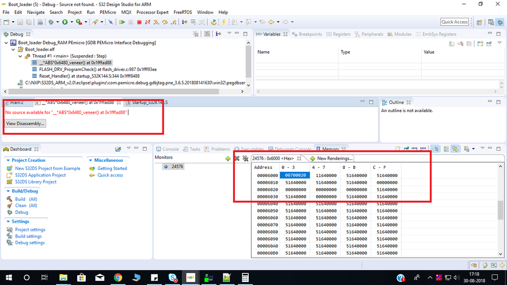

mrajanna
Contributor V
Hi Jiri,
I could successfully receive hello.bin file. But receive buffer is all zeros. This could be one reason.
Function calls to erase and program flash memory(address = 0x6000, size = 2000) is all success.
After writing hello.bin to pflash, I see only zeroes at 0x6480(below screenshot). I have doubt on whether bin file was properly generated from elf file.
After pressing F8, I see program stops in DefaultISR(below screenshot).
Do you have any comments please.
If you don't mind can you please try once on your setup ?
Mohan

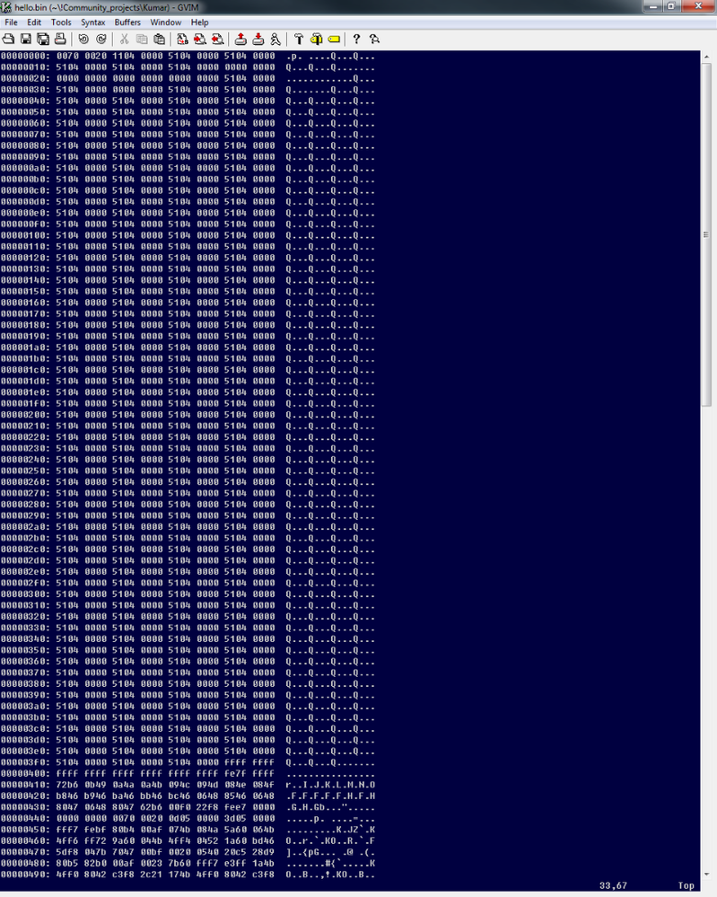

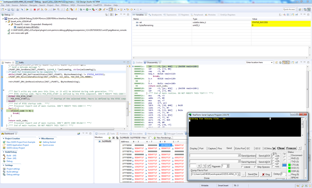

jiri_kral
Hi Mohan,
the bin file (from attachment above) is okay - you can check it in some hex editor (for example VIM):
You can see that modified lpuart echo example (attached above too) can receive bin data correctly - on screenshot you can see vector table in memory view - in the RAM. I'm using RealTerm for transfering binary files.
 Can you share your project?
Jiri

jiri_kral
Thanks for sharing the project. So - I fixed some stuff - the main issue was enabled IRQ during flash operation. Now can be bin data  flashed:
After jump to 0x6480 is the hello project running (you can see blue LED turned on/off by button).
Jiri

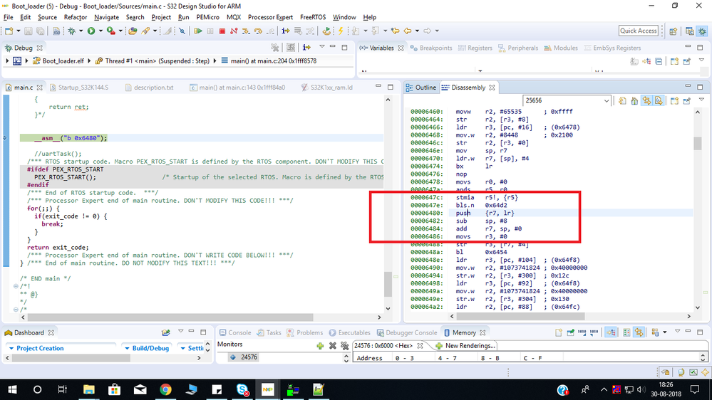

23,234 Views
sreevishakhkp
Hi Jiri
I am trying to execute the same file you have attached here.I am able to read the binary file through UART but branching instruction is not success.Please find the error log.error.png
23,233 Views
jiri_kral
it looks like that you are jumping into interrupt vector table instead of main (or your entry point).
Jiri
23,233 Views
jiri_kral
Well, try to check if your main() function is really on address where you are jumping.
23,233 Views
