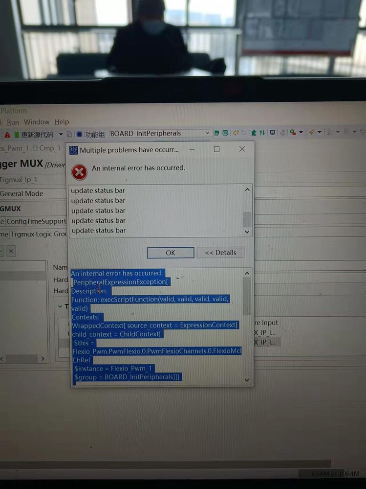

An internal error has occurred while tried to add drivers such as flex_pwm to the project using Peripheral config tool .
2,833 Views
mikedoidge
Hello Steven,
I was able to reproduce your issue. An internal ticket has been logged for this issue. I hope to have some solution or workaround for you soon.
Mike
2,810 Views
steven_zhang
Contributor V
i add the flexio_mcl before adding the flexio_pwm,error is disappeared .
