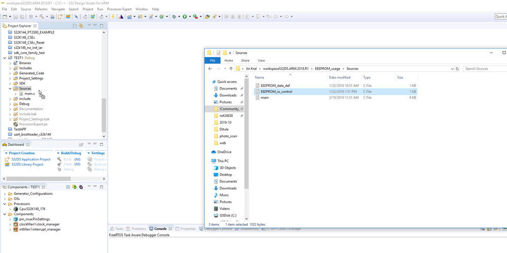

i am using S32 Design Studio for ARM 2018.R1 and have created an application project.  I want to add some existing source files to the project but can't figure out how to do it.  How is it done?  Thanks

you can for example drag and drop your source file or simply copy your sources into workspace/Project/sources and include folder. There is nothing special about it.

I did that, but didn't see the file in Sources until I figured out that I had to right-click on the folder and selet 'Refresh'.  then it showed up and became part of the build.  thanks
