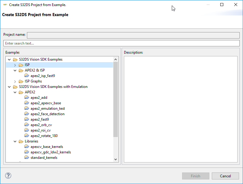

part of S32DS for Vision are examples - including the Apex ones:
Documentation for Apex is located in:
[YOUR_INSTALL_PATH]\S32DS_Vision_v2.0\S32DS\s32v234_sdk\docs\apex\
folder.
