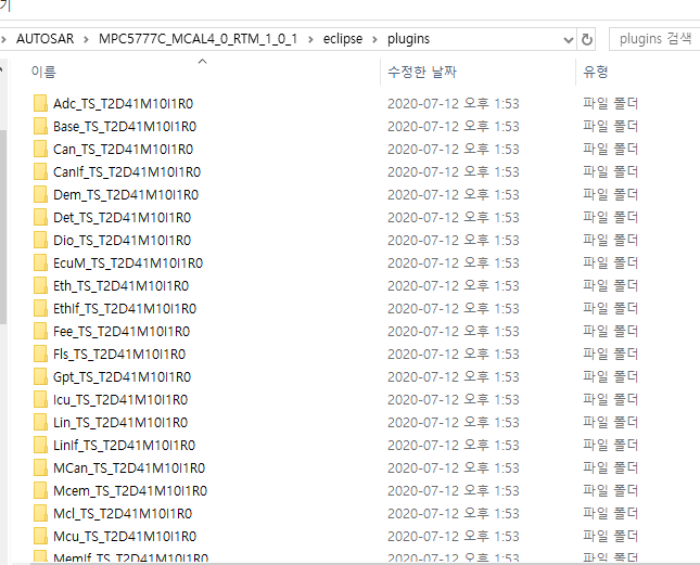

I can acquired the MCAL for 5777C and EB Tresos tool in nxp autosar software section and I setting the MCAL for my EVB and generate the MCAL BSW code.
this is Generated code from EB tresos

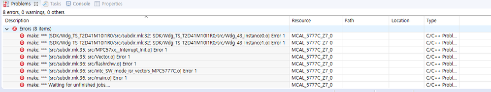

However when I trying to merge and build the project with S32DS, It is not going very well.

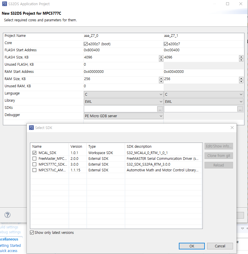

First, I make a SDK(software devlop kit) for my own.
This is what from the MCAL setup file, there is Plugins for make SDK(maybe not).
I make a SDK in S32DS like this link https://www.programmersought.com/article/68541996409/
And make project with SDK.
But when I Built it, error is accur.
How can I merge the MCAL Generated code with S32DS?

it's hard to say what's wrong. The easiest way how to use MCAL is just copy ganerated sources into your project. What's your compiler? MCAL is not supporting gcc.

I think I have to copile with GHS.
