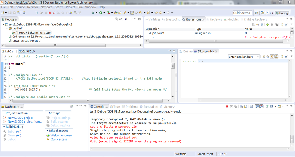

I use S32 DS IDE(v1.1) include GHS compiler(v2015.1.6) and run test3 project in KIT33908MBEVBE+KITMPC5744DBEVM.
The project can be compiled, but the process occurred error in debug mode.
It brothers me one week.Could someone give me advice, please?
Thanks a lot.

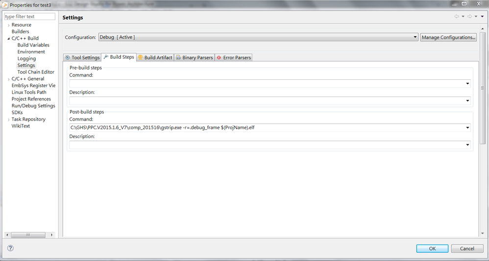

Hi Martin,
I delete .elf, but some problem occurred as follows. Where do I need to set it?
Thanks a lot.

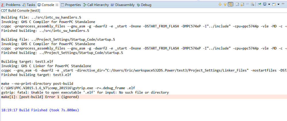

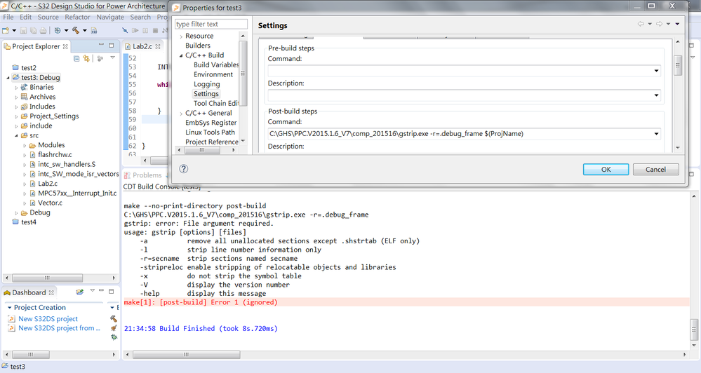

erichsu
Hi Martin,
I add the command as follows, but  there was an error after compilation.
Where should I set  "Build with optimizations off (-Onone) or debug options on (-Odebug) or a variation of those."?
Console log:

martin_kovar
I am sorry I forgot one point. You have to delete .elf from command inserted to Post-build step.
Martin

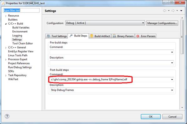

martin_kovar
This sounds like a known issue with GHS build tools. There is a workaround which does not completely resolve the issue, but it improves debugging:
  • Build with optimizations off (-Onone) or debug options on (-Odebug) or a variation of those.
  • After the build, run our gstrip utility on the executable and remove .debug_framegstrip -r=.debug_frame <executable>
Add this command as a post-build step:
Please let me know, if it helps you.
