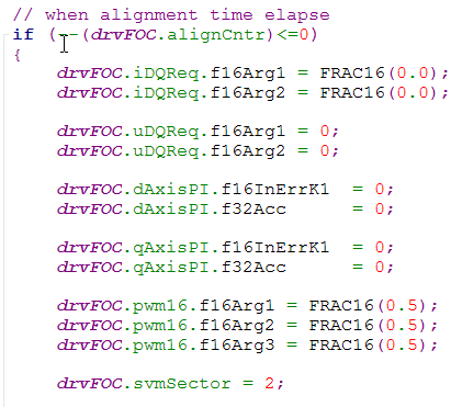

Dear friend:
                 I have a problem which is in the stateAlign function of AN5327 .
 Ud is 3V,Uq is 0V.After alignement , drvFOC.alignCntr is 0, and the rotor is stop , drvFOC.svmSector is 1.
why the drvFOC.svmSector is 2 ?
