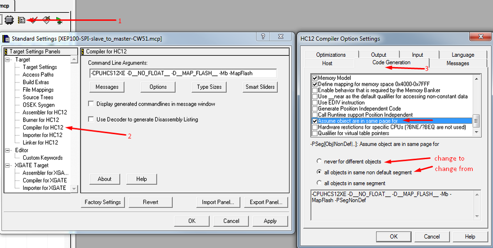

Hi ruby,
please be aware, there is compiler/linker optimization.
When two variables are located in the same banked non default segment, Compiler/Linker suppose that they are in the same page and remove paging operations.
You could disable this optimization.
Go to project settings (Alt+F7), Compiler for HC12, Code Generation, check “Assume object are in same page for” and change settings to “never for different ojects”. Or you could simply add “-PSegObj” into Compiler Command Line Arguments.
I hope it helps you.

kef2
Senior Contributor V
Radek,
since Ruby is using __GPAGE_SEG and all RAM fits the same GPAGE segment, there's no need to worry about -PSegxxx switch, all settings must be fine. Ruby's issue must be somewhere else.

RadekS
Hi Edward,
You are right, I missed that point.
Ruby,
Could you please share with us your code for operations with these variables (copy,..)?
RadekS
