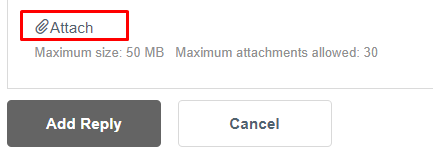

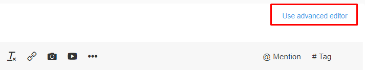

Unfortunately, I was not able to found the right option of how to download it without registration or specific application. Probably just problem with web page translation.
If you want to upload attachment here, please click on Use advanced editor link at the top right corner of your reply window.
After that, you will see the attachment upload option directly under your reply.
Radek
