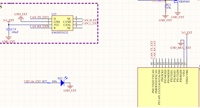

I'm trying CAN bus communication on s12g128.I tried http://cache.freescale.com/files/microcontrollers/doc/app_note/AN4455SW.zip CAN example but i didnt work.

what does it mean exactly "it didn't work"? At what line code the problem occurs?
What board do you use? Is it a tower board?
Note that in the CAN example, the Loopback Self Test Mode is enabled which means the MSCAN performs an internal loopback which can be used for self test operation. The bit stream output of the transmitter is fed back to the receiver internally.
The RXCAN input is ignored and the TXCAN output goes to the recessive state (logic 1). The MSCAN behaves as it does normally when transmitting and treats its own transmitted message as a message received from a remote node.
In this state, the MSCAN ignores the bit sent during the ACK slot in the CAN frame acknowledge field to ensure proper reception of its own message. Both transmit and receive interrupts are generated.

"it didnt work" means; I can't see any chancing on oscilloscope.There is no bit stream.
I use own design.I attached schmatic.
