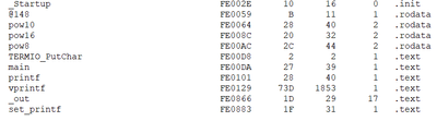

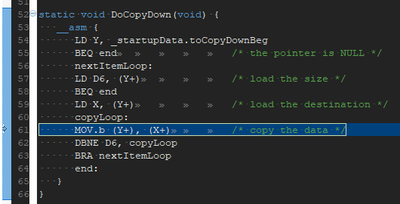

It is copy down function. The evidences are listed below:
1. If we set a watchpoint at the RAM address (4631 (0x1217)), the program will stop there during DoCopyDown execution.
2. The string "%d %ld %u\n" is located at both RAM and flash:
fqh_1-1732505569730.pngfqh_1-1732505569730.pngfqh_2-1732505621548.pngfqh_2-1732505621548.png
3. The COPYDOWN section

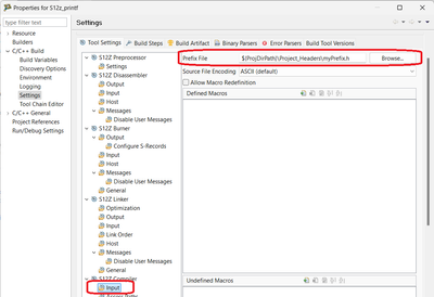

stanish
strings are considered as data by default.
To avoid copydown you can place pragma below:
#pragma readonly_strings on
e.g. add a prefix file (e.g. myPrefix.h):
#ifndef MYPREFIX_H_
#define MYPREFIX_H_
#endif /* MYPREFIX_H_ */
 to include it to every source file in your project you add the prefix file here:
Now the object that represents strings (@148 in my example)is located at flash:
Hope it helps,
Stan
