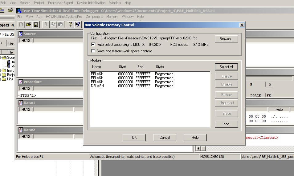

Dear all,
working with mc9s12XEG128 (cpu id 0x2dd) doing some gcc tests with this mcu, looks like, from some wrong objcopy flag generating s19, i have programmed wrongly the mcu from Codewarrior "hiwave". Programming succeded but just after i cant re-program the flash anymore, getting several <timeout>. Background debugger can still connect but nothing more, any erase / program attempt fails in timeouts.
What do you suggest ?
I have also created a brand new CW project from wizard, for this part, nothing changes.
I can in case replace the IC but i hope i can recover someway.

Dear Radek,
thanks for the kind reply.
Well, device looks already unsecured.
I tried both Code Warrior debugger menu ->HC12MultilinkCyclonePro->Unsecure and also P&E unsecure tool, both says device
is unsecured.
Also, i suspect i erased the device ID .... or that the debugger can't read correct device ID, debugger menu "HC12MultilinkCyclonePro->Flash"  shows a strange 0x02dd value (and strange memory map), while i was expecting a 0xc082
thanks

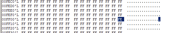

Hi Angelo,
I am not aware of any way how to erase device ID from the customer side.
I see some Timeout on the picture with the debugging map and empty windows. It rather looks like some issue with connection to MCU (The BDM communication may be interrupted by reset or MCU may be secured).
When you modify any value in range 0xFF08~0xFF0F (as in your case), please enter FLASH NOUNSECURE command into preload file (your_project_dir\cmd\).
You are right, in debugger Flash menu you may erase the default flash security byte at address 0xFF0F and reprogram it by your s19 file. This is a second possible way how to avoid potential ECC error at 0xFF08~0xFF0F flash phrase.

RadekS
Hi Angelo,
According to your description, it rather looks like secured MCU.
Please try using the unsecure feature in CW In Code Warrior debugger menu ->MultilinkCyclonePro->Unsecure…
It should completely erase the whole MCU…
The reason for secured MCU may be probably ECC.
Datasheet says:
"If a double bit fault is detected while reading the P-Flash phrase containing the P-Flash protection byte during the reset sequence, the FPOPEN bit will be cleared and remaining bits in the FPROT register will be set to leave the P-Flash memory fully protected."
The security byte at 0xFF0F address is programmed to 0xFE by default. If we load any data into phrase 0xFF08~0xFF0F, we have to erase security byte first.
This may be solved by “FLASH NOUNSECURE” command in preload command file (P&E_Multilink_USB_Preload.cmd if you use PE Multilink).
