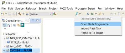

In case it is S12(x) family there is an option to enable/disable erasing of EEPROM (go to File -> Configuration dialog - where you can specify which flash memory blocks should be erased:
If you use S12z the debug will erase just Program FLASH. in order to program EEPROM you should use Flash Programmer component (Target Task):
Hope it helps.
