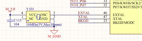

I am using the CPU MC9S12XEP100,and using CMOS Compatible External Oscillator,

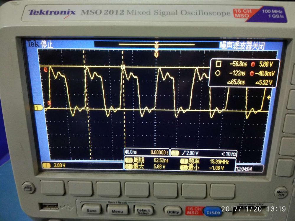

Question 1:the  Lock bit of the CRGFLG Register can not change to 1,it is always 0,why?the oscillator Circuit and scope as below:
the same program in Many other CPU can change to 1 and work normaly,but individual CPU can not change to 1,why?

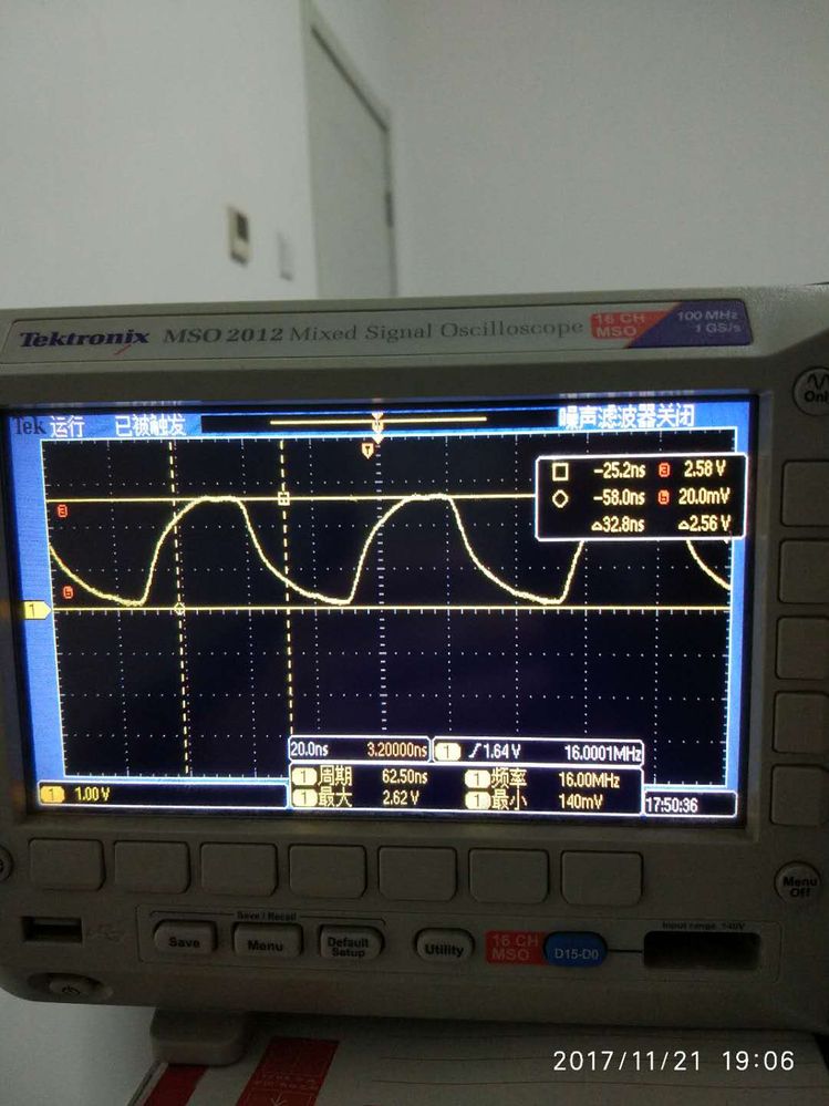

Question 2: The CPU can not download the program after change the Oscillator Circuit,why?the changed Circuit and scope as below:

The clock must be 1.8V CMOS compatible.
But the amplitude of your clock is over 5V.
Please refer to the below specification,
Table A-1 Absolute Maximum Ratings.
Table A-24 Oscillator Characteristics.

It is difficult to say why some MCUs work and others don’t. Is it possible that they are running in Self Clock Mode instead? Indicated by CRGFLG[SCMIF, SCM] bits.
Anyway, the external clock must not exceed the specification given in the RM.
Otherwise, the functional operation is not guaranteed.
