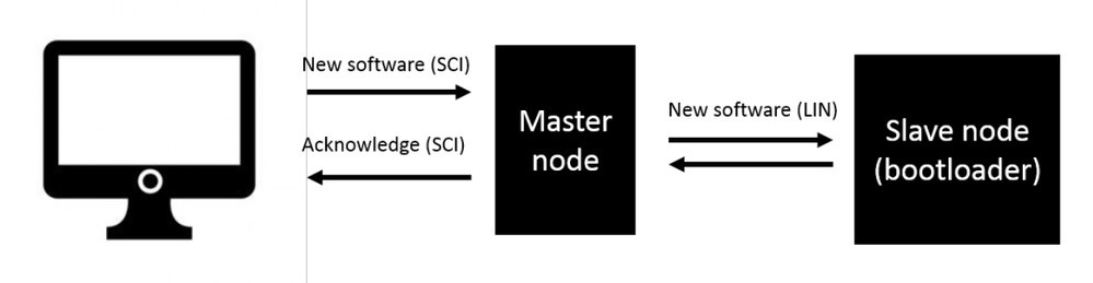

i want to implement the LIN bootloader on ZVMBA64.
i find a AN named AN5389,in this AN,there is a  Application diagram ,as bellow:QQ截图20171107155152.png
the bootloder needs a master node,i want to that is there a master node demo board or demo code?
thanks!

danielmartynek
LIN examples for S12ZVMBA are abailable in
LIN2.x and SAE J2602 Stack (REV v4.5.9)

jinhui_wu
is there demo board
2,558 Views
danielmartynek
S12ZVMB Evaluation Board features the S912ZVMBA6.
