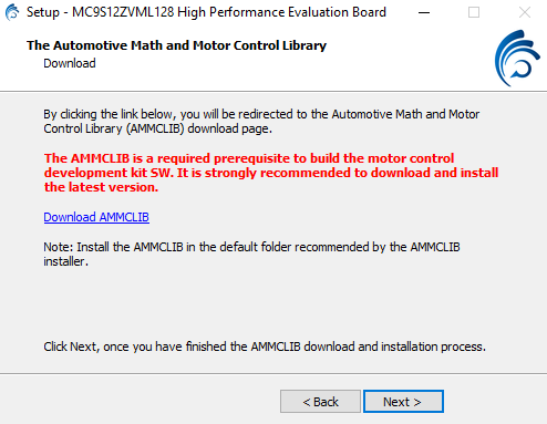

hi,
i m trying to import example projects in code warrior ide.
https://www.nxp.com/document/guide/get-started-with-the-mcsxsr1cs12zvm-evaluation-board-for-3-phase-...
i am facing issue with build. i don' t know what i did wrong. there are approx. 100 error with "build project". can you tell me right way to import example project in ide

Hi @bezzie,
Did you installed the latest AMMCLIB?
The installer should ask you to download and install the library:
BR, Daniel
2,285 Views
bezzie
thank you. issue solved.
