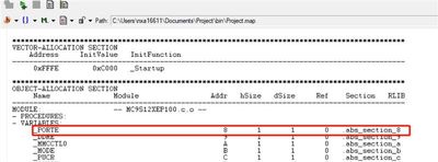

Hi NXP,
What is the meaning of hsize ,dsize and ref in map file of S12 Application Project.
Plz refer the attached image.
1,698 Views
lama
Hsize/dsize is a size of variable in hex or decimal.
Variable arr_ub is array of size 10 bytes (0x0A bytes) and placed at global address 0x400000 in the MY_EXSRAM0_CSO memory space defined in the prm file.

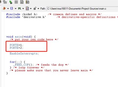

Add following code to the application source code below. PORTE is used twice

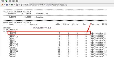

Build the project, in map file, we will see PORTE is increased to "2"

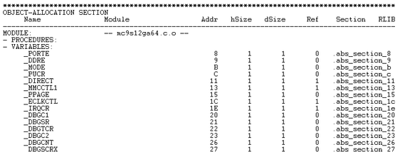

dSize - decimal amount of bytes, hSize - the same in hex.
