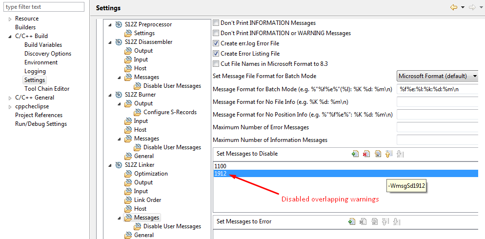

Example:
Default Flash range for S12ZVC is defined as:
ROM          = READ_ONLY  0xFD0000 TO 0xFFFDFF;
Note: Range 0xFFFE00 to 0xFFFFFF is used for vectors.
We want use for example range 0xFE0000 to 0xFE7FFF (32kB) to storage our user data. In that case we should define Flash as:
ROM1          = READ_ONLY  0xFD0000 TO 0xFDFFFF;
ROM2          = READ_ONLY  0xFE0000 TO 0xFE7FFF;
ROM3          = READ_ONLY  0xFE8000 TO 0xFFFDFF;
And section “PLACEMENT” will contain:
      DEFAULT_ROM,
      COPY              INTO  ROM1, ROM3;
In that case, default code cannot be placed into ROM2 area since this area is not in default placement.
When we want store also some data (code or constants) into ROM2 area as part of our project, we could create our own segment in section “PLACEMENT”. For example:
MY_DATA  INTO ROM2;
In our C file we could place our data into this segment by pragmas. For example:
#pragma CONST_SEG MY_DATA
const unsigned char test1 = 0xAA;
#pragma CONST_SEG DEFAULT
Note: CONST_SEG pragmas are used for constants placement. CODE_SEG pragmas are used for code placement. DATA_SEG pragmas are used for variables placement.
Note: these pragmas are not limited by end of file, therefore I would like to strictly recommend return to default settings (#pragma xxxx_SEG DEFAULT) inside this file.
This way we could simply drive placement of code/constants/variables in MCU memory map.
Note: If possible, I would like to recommend do not use direct placement like:
const unsigned char temp1 @0xFE0000 = 0xAA;
without exclude this area from linker memory map. Linker does not aware about that data in code placement and any overlapping just lead to warning message. Unfortunately default CW10.6 project has disabled these warnings due to 24bit register constructions in S12Z derivative header file.
I hope it helps you.

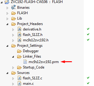

10,230 Views
sathishkannan
thanks alot for the explanation.
Can you explain how to open and see the linker file from codewarrior for particular project.
10,230 Views
RadekS
RadekS

RadekS
Hi sathish,
Please use procedure four posts above for modification in your prm file.
EEPROM or P-Flash (marked as ROM for linker) could be used for storage your data.
User data placement depends on your needs however I would like to recommend keeps user segments (which you plan to rewrite by code) aligned with sector size.
More details about linker and prm file could be found in file:
"c:\Freescale\CW MCU v10.6\MCU\Help\PDF\MCU_Build_Tools_Utilities.pdf"
