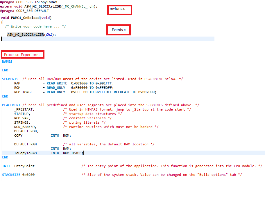

byeongjinkim
change to PWM reload interrupt.
how to executing in ram? Do I need to copy all the memory?
 ToCopyToRam(0xFFEE00 ~ 0xFFFDFF) ㅡ> (0x002000 ~ 0x002FFF)
all copy?

RadekS
Hi Byeongjin,
When you will define some function directly on RAM like your original proposal, the function will be compiled for work in RAM and automatically copy from Flash to the RAM during Startup() – like variable initialization. For example:
#pragma CODE_SEG DEFAULT_RAM
void MY_Function(void)
#pragma CODE_SEG DEFAULT‍‍‍‍‍‍‍‍‍‍‍‍
Please be aware that the same #pragmas must be used also for function prototype.
The next option is compiling code for run in RAM and copy it there manually – as it is used in your next post (using RELOCATE_TO qualifier in prm linker file).
In that case, you should create a function which will copy ToCopyToRam section to the RAM (starting from 0x2000).
For example:
static void CopyCodeToRAM(void)
  UINT8 *Src;
  UINT8 *Dst;
  UINT16  SegSize;
  UINT16  x;
  //RAM code resides in Flash from 0xFFEE00 to 0xFFFDFF
  Src = (UINT8 *)__SEG_START_REF(ToCopyToRam);
  Dst = (UINT8 *) 0x2000;          //copied to RAM at 0x2000
  SegSize = (UINT16)__SEG_SIZE_REF(ToCopyToRam);
  for (x = 0; x < SegSize; x++)   //just copy a byte at a time
    *Dst++ = *Src++;
