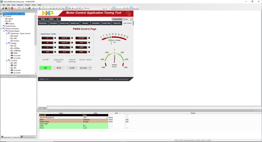

I have the same error and when I reduce the AlignVoltage value to zero, the motor goes to the Align state then to the operating state, but the motor does not run.run.PNG

pachamatej
Have you tried to request speed form the "green" range? The open-loop start-up might have a problem with such small speed.
