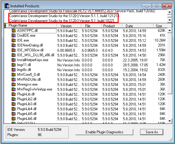

Just for sure, what MCU family you use (S12XE, S12XD) and what CW version you use?
