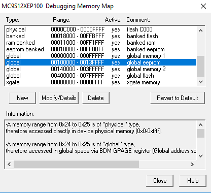

  • please unsecure your MCU and load AN3743 code into MCU.
  • Please write 0x25 into MMCCTL1 register at address 0x0013 for enable EEE IFR visible in memory map.
  • After that, please go to Debugging Memory Map - Modify "global eeprom" range 0x100000~0x13FFFF and check "refresh memory when halting".
  • After that, please go to memory "0x120000'G". There you should see 0x0074 0x0074 0x0001 0x00001 values (DFPART, ERPART and their backups) after partition command execution(/***********(3)PERFORM FULL PARTITION OF EEE RAM***********/)
  • at address 0x107F00'G you should see 0xFACF 0x0000 value as last sector header. In such case, the D-Flash was correctly formated.
  • When you will step over code, you should see EEE values change at address 0x13FF00'G or 0x0F00'L(in such case, please check "refresh memory when halting" also in "eeprom" memory range 0xC00~0xFFF).
See attached memory map for more details about local and global addresses.

I’ve added code to set register MMCCTL1 at 0x0013
At address 0x120000’G there is only 0xFF values after stepping through.
The Debugging Memory Map is setup as you stated.
After partitioning the address 0x107F00’G is 0xFF.
The address starting from 0x13FF00’G is not changing and does not display the same values as with the Demo board from the start.
Stepping through our project an error is displayed as below and the code stops in a ‘while’ loop. See below indicating a problem in the values of FSTAT and FERSTAT registers.
Going back to our project. Before starting the Debug step through the address range from 0x13FF00’G is not correct. See below.
On the Demo board it is as below with ‘BEFORE’ already written to memory starting 0x13FF00’G.

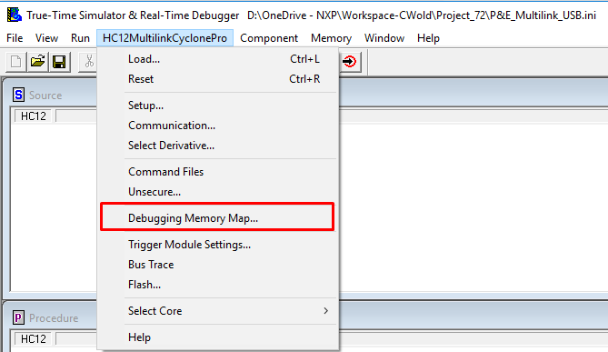

I’m sorry I can’t find the Debugging Memory Map in the P&E CyclonePro settings.
John
58,927件の閲覧回数
RadekS
Hi John,
When you click on Debug button, the debugger will erase Flash and EEPROM by sectors – this is not mass erase. Please, do not believe to the information from image003.png warning.
Please use unsecure command if you wish erasing Partitioning.
I would like to apologize. My mistake, that last D-Flash sector starts at address 0x107F00 and not at 0x13F000.
Please make screenshot of your P&E CyclonePro settings.
Mine is:
