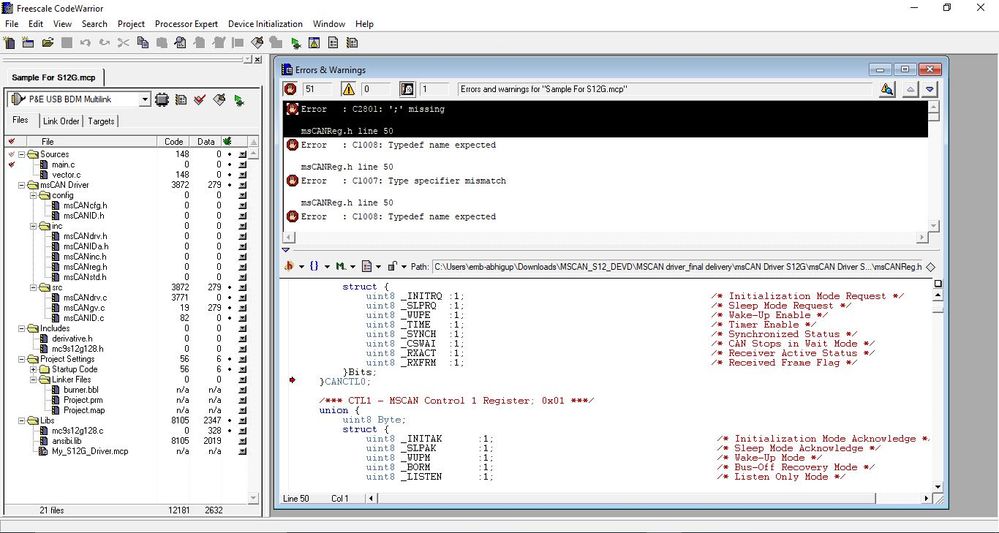

abhi1992
Hi Daniel,
It is a syntax type error. Please have have a look at attached snip below. Can you try compiling the same work-space which I downloaded from st website. Please refer this link and download the Work-space named " MSCAN driver for S12(X) devices " . See Link:

danielmartynek
There is a problem in header files.
Header file msCANReg.h defines unions (such as CANCTL0) that are already defined in the original S12G128 header file mc9s12g128.h and used in the mc9s12g128.c file.
I have commented all the declarations in the mc9s12g128.h, mc9s12g128.c files and the CW5.1 doesn’t complain anymore. But I haven't tested the driver after the modification.
