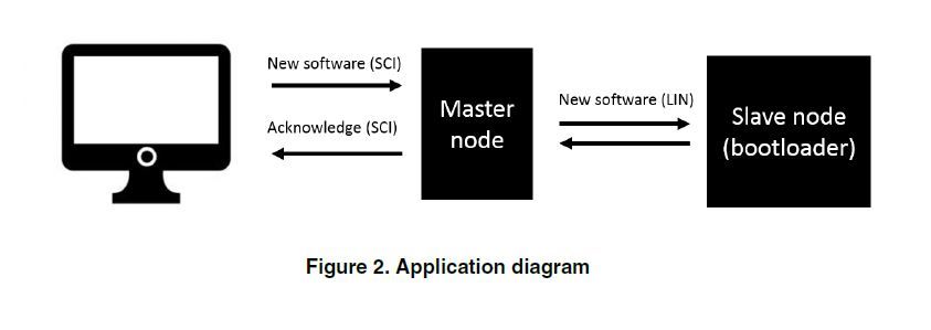

I'd like to setup a test environment for LIN bootloader on MM9Z1J638.
Currently, I have a KIT9Z1J638EVM Board.
My target is to download IBS application code(Motorolar S-rec image) into the KIT9Z1J638EVM via LIN.
I'm not familiar with S12Z MCU and LIN protocol yet, so I'd like to setup a bootloader system like the picture above with the exist EVB board.
Could you please recommend which EVM boards I need to purchase to learn and practice myself the LIN bootloader, (Master-node and Slave-node both at the same time) ?
I'd like to purchase Demo programs with the EVMs too.
First of all, I'd like to learn "LIN bootloader" by following the quick-start guide with the demo program, without any change by myself.
Many thanks in advance.

#1)  If I purchase two sets of "S12ZVL" EVM from the link below,
 DEVKIT-ZVL128: Development Board for ZVL128|NXP https://www.nxp.com/products/processors-and-microcontrollers/additional-processors-and-mcus/8-16-bit...
Is it possible to configure the first one as a Master-node and  the second one as a Slave-node with the different SW ?
And where can I get the bootloader SW for Master-node, and bootloader SW for Slave-node ?

Since the Figure 2 is taken from AN5389 S12Z MagniV LIN Bootloader, I assume you have already come across this application note.
The software can be found at this address: https://www.nxp.com/docs/en/application-note-software/AN5389SW.zip
It includes software for both the master and the slave ported on S12ZVL128.
So, you can use DEVKIT-ZVL128.
I’m not aware of any LIN bootloader ported directly on MM9Z1J638.
