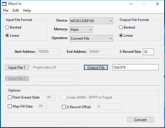

I just want to use the SRecCvt-GUI to convert the Project.abs.s19 file for CAN-BootLoader(xep100) using.But when I do like the follow :
then click convert,but no output file. I just donot why.Hope your answer.

Hi Chuan,
Appears there any error/ok message when you click on Convert button?
Please check whether you have write access to this directory.
Are you sure that your Project.abs.s19 contains S-record data with addresses in Linear format?
By default, the CW generate an S19 file with addresses in Banked format. The Linear address format is typically used for generating *.glo files.
You may press Ctrl button and start SRecCvt-GUI.exe file. This will start SRecCvt in Debug mode (You will see Debug Command window). This may help you tracking down a source of the issue (error code, when you click on Convert button).
