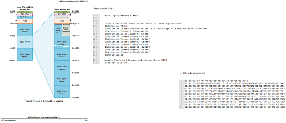

I meet a problem when programming .s19 file with trace 32 for MCU S12G128. .s19 file is in physical address. How to solve this issue?
Thank you.

gary_lu1
For S12G128 MCU, memory address can be located as local and global memory map.
Trace32 default script file(flash.cmm) seems support local memory map, when I want to program .s19 file with global memory map by flash.cmm, programming process will be failed.

Hi Gary,
the flash script should not be required in this case, just load the file like this:
SYStem.RESet
SYStem.CPU AUTO ;or replace AUTO with the processor name
SYStem.Up
FLASH.AUTO ALL
Data.LOAD.S1 <file> G:
FLASH.AUTO OFF
Register.RESet
If the flash programming result is still not as expected, please check the loaded address ranges using
sYmbol.List.MAP
and try to program again using Data.LOAD with option /FLAT:
Data.LOAD.S1 <file> G: /FLAT
Reinhard

gary_lu1
Hello Reinhard,
I try like follows, it works for programming. Thank you.
SYStem.RESet
SYStem.CPU AUTO
SYStem.Up
FLASH.AUTO ALL
FLASH.AUTO OFF
Register.RESet
