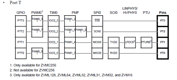

I am working with S12ZVML64 MCU, and specifically with PWM application. Please help with the clarifications. I have below 2 doubts.
1st Clarification:
From datasheets, in MODRR2 routing register, only Input capture can be routed.
I want to make sure whether routing of IOC2 to PT2 pin is required for S12ZVML64 MCU.
Is it safe to assume that no routing is required from IOC2 to PT2 pin of the micro ?

Hi, no, not only input capture. The MODRR2 is good to be read step by step and think abot function. Some of them are really input only because they connect internally the pin to another peripheral input for specific application functions.
The PT2 pin #52 at 64pin LQFP can be used for PT2 / IOC0_2 / (PWM0_5) / (SCK0) with the peripheral priority from left (lowest) to right (highest) as can be seen in the table 1-8 Pin Summary. If more than one peripherals are enabled at the pin the enabled peripheral with the highest priority  takes precedence over all others.
As you can see from the picture it has also no special connections to other peripherals. So, MODRR can be excluded from considerations.
Of course other peripherals can be routed to this pin  (PWM0_5) / (SCK0)
By default MODRR2 the PT2 contains TIM0 IOC_2 connected to the pin if IOC function is enabled. The IOC2 can be rerouted to PS1 in this register if you want but this is not the case.
Both functins are available at the pin ... IC or OC.
To sum up, do nothing just enable TIM and it will be connected to PT2 by default.
