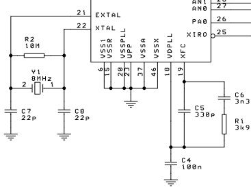

Here is the schematic of the oscillator section.
Test pin (23) is connected to GND as is the \XCLKS (pin 13). C7, C8, C6 and C5 in the schematic are of NP0/C0G type.

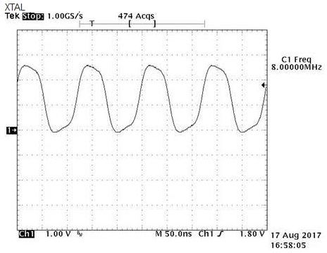

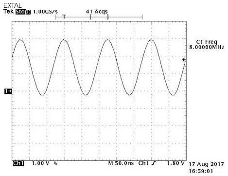

I have also tried many different crystals and load capacitances, and R2 values between 1 and 10Mohm. All with the same results... Tried also to change the processor. Oscillator should be OK and running because the waveform at XTAL output is OK?

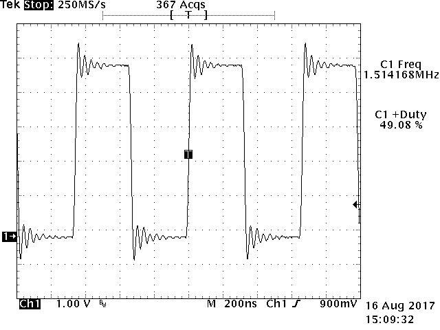

Since it is running at SCM, the pin PE4 shows the self-clock frequency / 2 rather than 4MHz that it should be with the 8MHz crystal.

kef2
Senior Contributor V
Did you check voltage at VDDPLL and VDD1? Is regulator working or indeed shorted to VDDX/VDDR?
I would check with probe if /XCLKS is really low.
Edward
