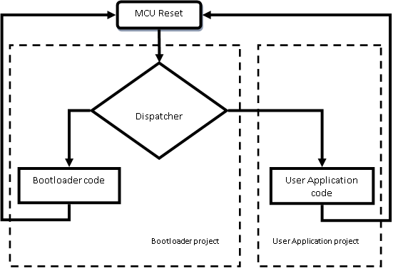

The switching between Bootloader and User Application codes is managed through MCU reset. So, the Bootloader and application are not limited by write-once registers.
The Bootloader Project itself contain small user-defined dispatcher code which is executed directly after MCU reset and decide whether Bootloader or User Application will be executed as next.

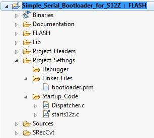

3.1.     Bootloader Project Folders
The C language codes and appropriate header files are located in Sources and Project_Header folders.
The exception is Dispatcher.c and start12z.c files located in Project_Settings\Startup_Code folder.
The linker file is located in Project_Settings\Linker_Files folder.
The FLASH folder contain generated files like elf, map or s19 files.
The SRecCvt folder contains a SRecCvt.exe tool for re-formating generated S-record file.
The content of Documentation folder should help you in guide how to use this Bootloader.
Figure 3 Bootloader Project Folders

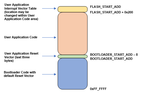

3.4.     Interrupt vector
In the case when the User Application using interrupts, it is necessary to relocate the interrupt vector table using the IVBR register.
The Bootloader resides in the upper 4/8/16kB fixed block at the address defined by linker prm file. This area is had to be protected (configured in Config.h), so the User Application cannot rewrite a default location of the interrupt vector table at 0xFFFE10-0xFFFFFF. The advantage of this solution is that the Bootloader cannot be affected by a power failure that could occur when rewriting User Application interrupt and reset vectors.
The Bootloader automatically moves User Application’s reset vector from address 0xFFFFFD to the  APPLICATION_RESET_VEC_ADD address = typically the end of User Application’s flash area. Since this moving is managed by the Bootloader, the whole phrase (by default from (BOOTLOADER_START_ADD-8) to BOOTLOADER_START_ADD) must be excluded from User Application’s linker usage and the same sector (512B) shouldn’t be used for User Application’s interrupt vector table.

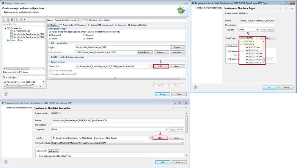

  1. Compile the project and download the Bootloader to the MCU via BDM device.
Note: The correct derivative should be selected in debug configuration for successful complete MCU Flash erase and programming (Figure 5 Select derivative for Bootloader download).

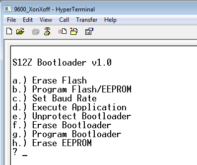

  2. Open the Microsoft HyperTerminal or any other serial terminal utility (e.g. Realterm, Tera Term,…). Set the baud rate 9600 bps, 1 start bit, 8 data bits, 1 stop bit, and flow control Xon / Xoff.
  3. Make sure there is a serial (USB to Serial) cable connection between the PC and the board.
  4. Hold the PUSH_BOTTON pin low and reset the MCU.

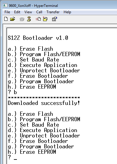

  5. The Bootloader is started and the following response is received in HyperTerminal. See Figure 6 Initial screen.
  6. Type “a” to erase the flash memory. This is not necessary the first time because the flash has been already erased by the BDM device.

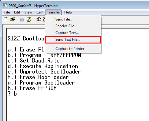

  7. Type “b” to program the flash.
  8. Now send the desired S-record as a text file — See Figure 7 Send Text File. Browse for S-record which is downloaded to the MCU. For testing purposes, use demo S-records that are attached to this application note. The S-records must have a specified format. Refer to chapter 3 How to write a User Application and to chapter 4.4 How to convert S-Record that will be downloaded by the Bootloader.
  9. Confirm the dialog and the S-record are downloaded to the MCU. One printed star (*) means that one line of S-record has been programmed. See Figure 8 Download User Application.

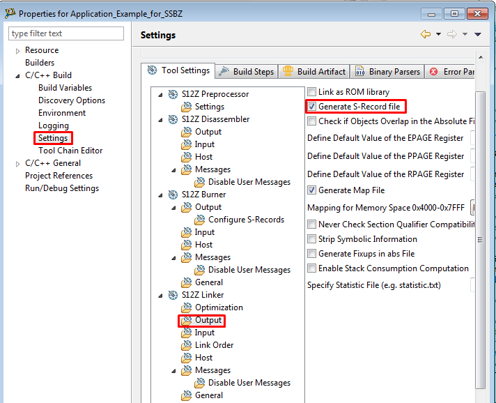

The default S12Z MCU project generated by CW10 does not generate a file with s-records automatically.
  1. Check option for generating S-Record file in User Application project settings per Figure 9 Generate S-Record file
The <YourProjectName>.sx file will be generated when you will build your project.

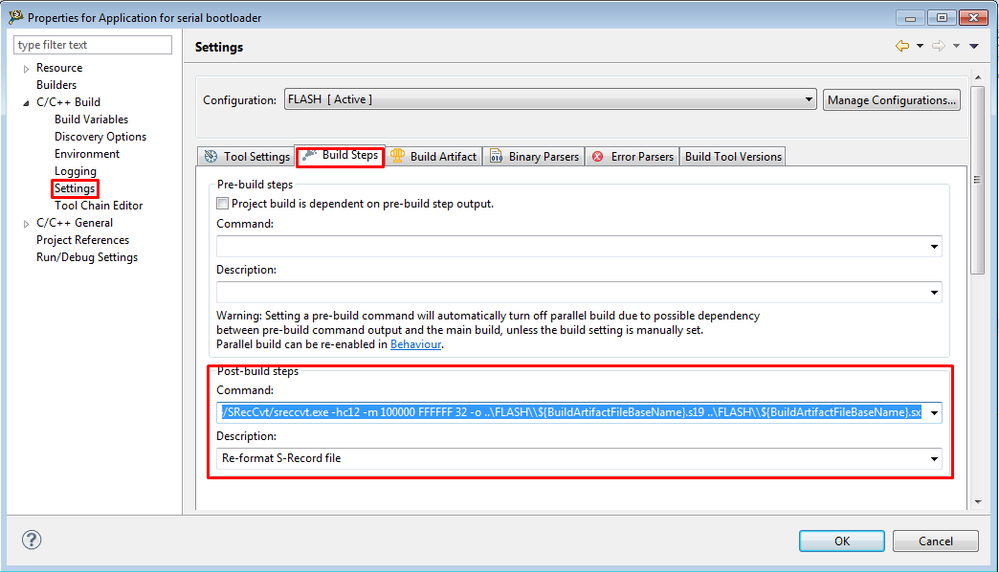

  2. Copy SRecCvt directory with SRecCvt.exe tool from Bootloader/Application Example project to your User Application project
  3. Exter command “${ProjDirPath}/SRecCvt/sreccvt.exe -hc12 -m 100000 FFFFFF 32 -o ..\FLASH\\${BuildArtifactFileBaseName}.s19 ..\FLASH\\${BuildArtifactFileBaseName}.sx” as post build step into User Application project settings per Figure 10 Adding Post-build step.
This command will load S-Records from your <YourProjectName>.sx file and create new <YourProjectName>.s19 file with reformatted S-Records when you build your project.

HEXFILE Simple_Serial_Bootloader_for_S12Z.s19
  5. Build the project. The final S-Record is ready to be downloaded into the microcontroller by the BDM interface.
5.  Testing
The Bootloader and example application were tested on evaluation boards:
  • DEVKIT-ZVL128
  • S12ZVMC256EVB
  • S12ZVM32EVB
  • S12ZVM-MINIBRD
