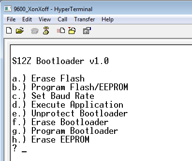

Thanks for reply. I have change my code as per given in AN12086 and able to start the communication and got this as hyper terminal output.
but when i try to program flash it will not respond anything. I am using s19 file as text file and which is generated by the same process as mentioned in application note. May be i am doing something wrong with memory addresses.

Hi Rajni,
The S-records must have a specified format.
At first, I need to ask did you use SRecCvt.exe tool for re-formating generated S-record file (s19 file)?
Please refer to chapter 4.4.     How to convert S-Record that will be downloaded by the Bootloader

rajnirajpoot
Hello Diana,
Yes i am using SRecCvt.exe tool for reformaring generated S-record file.
