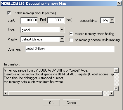

If you want watch D-Flash by the debugger, I would like to recommend enable “refresh memory when halting” feature in Debugging Memory Map (by default disabled).
Note: The picture is for different MCU.
