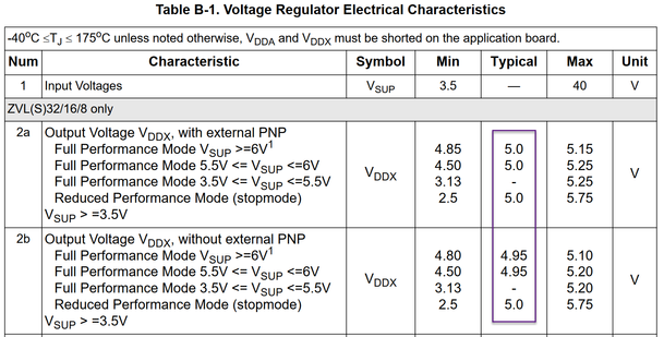

What is the state of S912ZVL64F0VLCR's BCTL without program? What is the output voltage?
What is the status of the program? What is the output voltage?
4,379件の閲覧回数
danielmartynek
Hi @Caleb1,
Out of the system reset, both regulators, the one with the internal ballast transistor and the one with the external ballast PNP are enabled.
The external regulator has a slightly higher regulating point (5V) than the internal regulator (4.95V).
That means that the external regulator tries to regulate the VDDX voltage higher and opens the PNP (BCTL voltage is slightly lower than VSUP)
Once the SW writes EXTXON = 0, INTXON = 1, the external regulator is disabled, that means Vemitter (VSUP) = Vbase (BCTL).
For this reason, the BCTL pin must be left unconnected if the PNP is not used.

danielmartynek
Hi @Caleb1,
While the debugger is attached, the MCU is in the Special mode, and the register can be written more than once.
But when the MCU runs stand-alone without the debugger, the MCU is in the Normal mode, and the register can be written only once.
Make sure that the register is written only once in the project.
S12ZVL RM rev.2.49, Section 4.3.2.1 Mode Register (MODE).

Caleb1
During the software debugging phase, setting registers makes it easy to open external pipes;
But after a slight increase, the external pipe couldn't be opened. Why is this?
What does the figure indicate as normal mode? When debugging, do you think it's not in normal mode?
What would it be like to write only once. Will the external pipes be turned off?
Thanks!

Caleb1
The current client's schematic design is the same as the schematic design provided
Adverse phenomenon: The normal output voltage of VDDX is 5V, but now it is 2.906V. The circuit behind this pin has been disconnected
Defective rate: The customer produced 60 sets and encountered 2 sets of this issue. If the power is cut off and then turned on again, the fault will disappear. I have done hundreds of power ups and downs, and this bad phenomenon will recur seven or eight times
The customer uses a normal board, erases the chip code, and then powers it on again. The output voltage of VDDX is 3.3V
