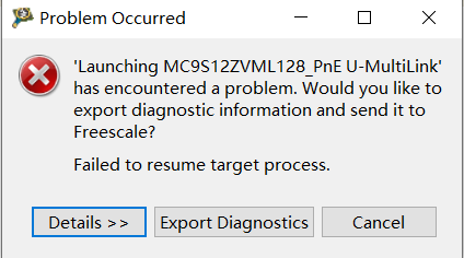

peter_shi
when add the LIN communication in demo code, elf file could be generated succesfully.
Codewarrior couldn't download code in MCU. Attached is detail information, Please help to check it.

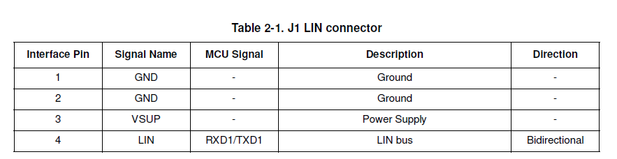

Let me apologize for the delay. In your code, you have selected SC0, but the MCU signals used for the LIN should be RXD1/TXD1 according to the user manual.
https://www.nxp.com/webapp/Download?colCode=S12ZVML-MINIBRD_UM
Note:  SC1 is already used in the S12ZVMLMINIBRD_PMSM_SW_CW11 example code.
Diana

I checked the LIN demo code as below. Demo code used SCI0 as well. Could you please help to check it? Thanks
It still could work for S12ZVMLMINIBRD.
LIN_stack_S12_4_6_3\Examples\S12Z_examples\Carcassonne_S12ZVM
Peter

The demo code from the LIN_stack_S12_4_6_3\Examples\S12Z_examples\Carcassonne_S12ZVM uses SCI0.
But this demo code is not written directly for the S12ZVML-MINIBRD. There are differences between the usage of the signals on other boards with the S12ZVML128 device. That is why you should follow the user manual of the S12ZVML-MINIBRD.
You can also, check the schematics to see which pins are not used on the board:
https://www.nxp.com/webapp/Download?colCode=SCH-28219
Unfortunately, there is no LIN example code directly for the S12ZVML-MINIBRD I recommend creating a new project, the demo code you can use a reference, and follow the user manual and AN5122.
I hope it helps.
Diana

peter_shi
5,711 Views
peter_shi
Hello Diana,
Attached is fault information.

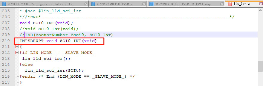

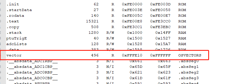

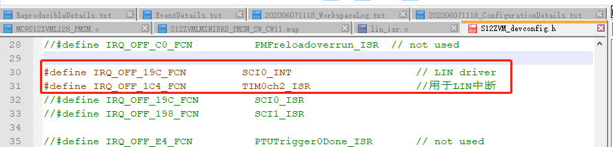

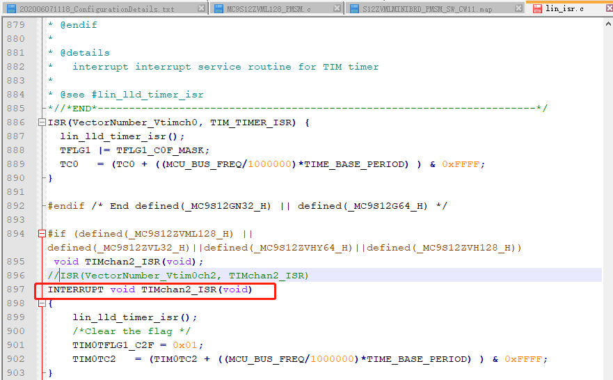

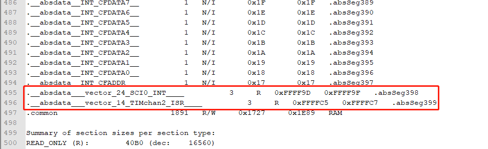

ArchieLuo
这是因为电机工程的中断与LIN工程的中断写法不同,导致有冲突。
从.map文件分析,这两个地方是存在冲突的。
解决方法:
建议将LIN驱动中的中断改成电机驱动代码中的中断方式。
另外,所使用的中断,需要在这个文件中定义一下。
最后,如有需要帮忙,可以联系我,[email protected]
