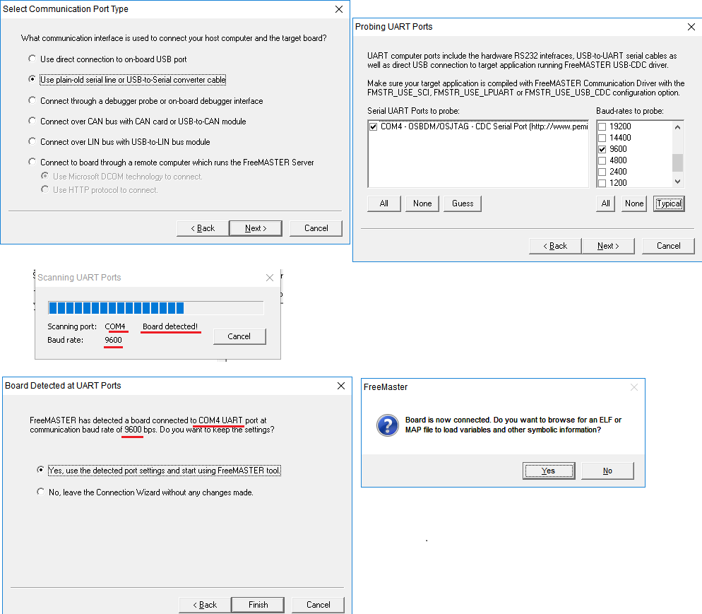

Hi code gurus,
Want to test –S12ZVMC12EVBCAN Kit, which has its OSBDM USB connection, have only freemaster software and codewarrior.
need a PMP file working with freemaster for BLDC sensorless motor control.
•Any one can help finding quick plug and play demo project for BLDC with S12ZVMC128evb and free-master control)
• Already found with the package of kit –BLDC: MTRCKTSBNZVM128 PMP freemaster project but also for S912ZVML12MKH  "MC9S12ZVML128_BLDC_Sensorless.pmp"
Can it work with the MCU S912ZVMC12MKH in my KIT mentioned first –S12ZVMC12EVBCAN
(NOTE:I don't have SIMULINK nor Matlab)
regards
Afarouk
5 返答(返信)
5,492件の閲覧回数
afarouk
Hi Diana
The answer is yes for all questions,

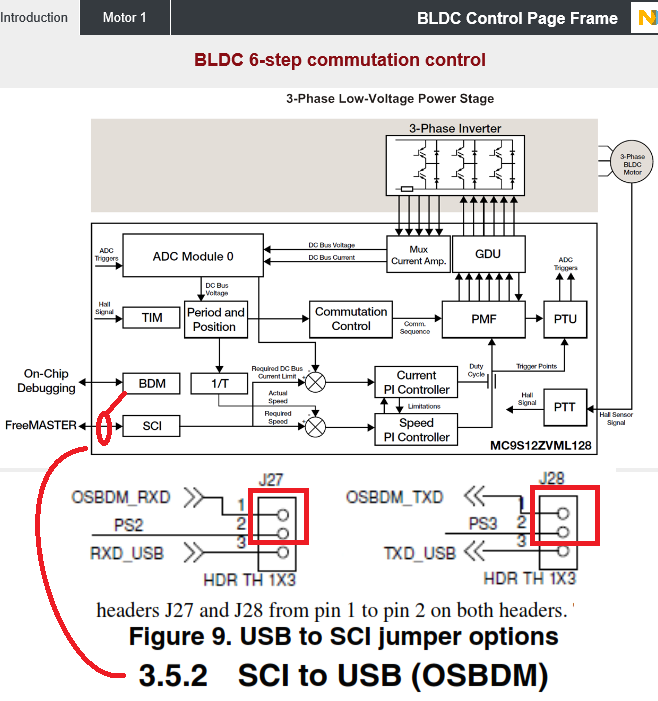

It is solved, by connecting serially through OSBDM UART

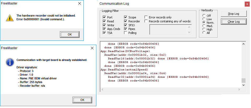

still, the error in communications between Freemaster and the KIT even after making jumpers of SCI1 to OSBDM Rx/Tx so, installed  CP20x driver and remake jumpers to J25 USB connector in the kit not communicated,
not worked only worked if serially connected like the last picture down
Untitled OSBDM port detected as UART J27and J28 to 1-2 jumpered freemaster worked.png
thank you a lot Worked Maximum DC volt is 17V minimum is 8V

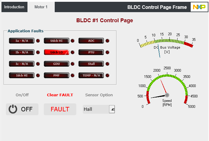

Hi Afarouk,
I have already tested the BLDC Sensorless application on the S12ZVMC128 and it works for me. I assume you want to use the BLDC sensorless application.
So, let's say the code is successfully launched in the CodeWarrior.
I have connected USB-to-SCI and PC by USB 2.0 A/M-B/M and 12V power supply.
The jumper settings is according to the QSG:  https://www.nxp.com/docs/en/user-guide/MTRCKTSBNZVM128QSG.pdf

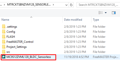

After that, I started the FreeMaster application version 2.0 and opened the Sensorless project:
After that, I set
and
next -> next -> next -> finish
After that, I'm successfully connected and application work without application faults.

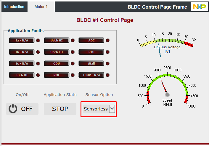

In the BLDC Control Page, please, select the Sensorless option:
I hope it helps you.

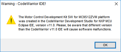

flashed the project with the package for MC9S12ZVML12 on my kit which includes MC9S12ZVMC12. accepted programming,
after open the PMP projects on FreeMaster nothing work, the connection through the same USB OSBDM to the kit.
Already tried both CodeWarrior motor control projects for hall sensor (MTRCKTSBNZVM128_HALL_CW11) and for sensor-less (MTRCKTSBNZVM128_SENSORLESS_CW10), but the same resultscodewarrior warning - codewarrior IDE.png
my installed CodeWarrior for MCU Version: 11.1 Build Id:181224
•• Should I have to install previous CW versions to suceed??

dianabatrlova
Hi Afarouk,
At first, I need to ask you a few questions.
Have you launched the project in the CodeWarrior successfully? (If yes, you can unplug USB OSBDM)
Have you connected USB-to-SCI (J25) to PC?
Have you installed the CP210x: USB to UART Bridge VCP Drivers - Silicon Labs?

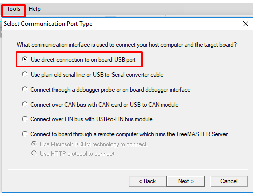

Have you configurated the communication in the FreeMaster: Project -> Options and set the Port and Speed: 9600?
If not works please try Tools -> Connection Wizard
If you have seen any errors could you send me the screen?
Thank you.
