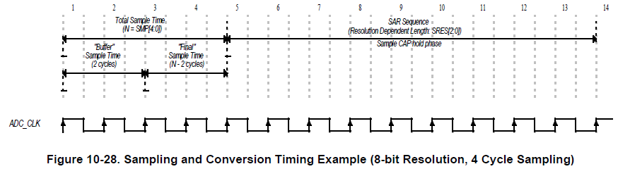

The ADC module needs a trigger to start sampling the first channel in Restart Mode.
It takes 2 BUS cycles + 2 ADC Cycles (pump phase) from the Trigger Event (bit TRIG set) until the select channel starts to sample. The pump phase (buffer sample time) is already a part of the Total Sample Time (N = SMP[4:0]), as described in Figure 10-28.
And the Total Sample Time is a part of the entire ADC Conversion Period (Table C-1 ADC Operating Characteristics).
10-bit resolution:
min. 18 ADC cycles (4 S + 14 C)
max. 38 ADC cycles (24 S + 14 C)
During a conversion sequence (back to back conversions) it takes five Bus Clock cycles plus two ADC conversion clock cycles (pump phase) from current conversion period end until the newly selected channel is sampled in the following conversion period.
Again, the pump phase is a part of the Total Sample Time (N = SMP[4:0]).
The conversion time of 36 commands after Trigger event in Restart mode is:
2 BUS cycles + (36 * ADC Conversion Period (18 – 38 ADC cycles)) + ((36-1) * 5 BUS cycles between two conversions).
